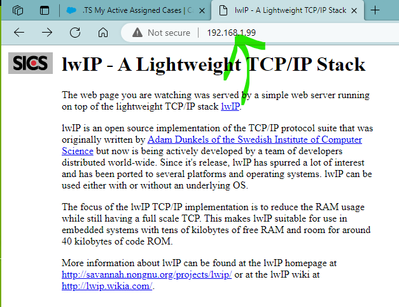

My project I need to send data through the HTTPS protocol. To understand this code i gone through the lwip_httpsrv_mbedTSL_bm demo code. This application demonstrates an HTTPS Server
set up on lwIP TCP/IP and the mbedTLS stack with bare metal. The user uses an Internet browser to send an https request for connection. The board acts as an HTTPS server and sends a Web page back to the PC.

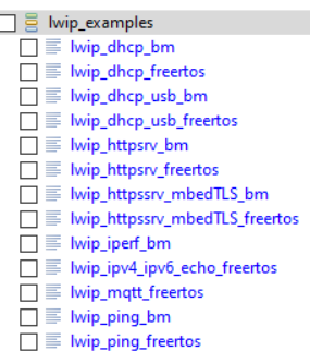

I have gone through all the lwip demos are under Lpcxpresso 54628 board lwip examples folder. In that lwip_httpssrv_mbedTLS_bm and lwip_httpssrv_mbedTLS_freertos, these two codes only for https, remaining all are for other protocols.
As I mentioned in previous message these two codes Lpcxpresso 54628 board act as a https server and pc as a client. but my requirement is that board should act as client and pc as a server. For this application can I get any API?

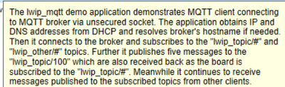

Hello, sorry I reviewed the SDK of the K64 and has the same example as server, could you elaborate further about your application? the server is where the page is allocated, and if you want the example as a client to connect to a PC for send telemetry the connection suggest is WebSocket or MQTT. I suggest review that protocols maybe are what you are looking for, and this example is available for your board.
