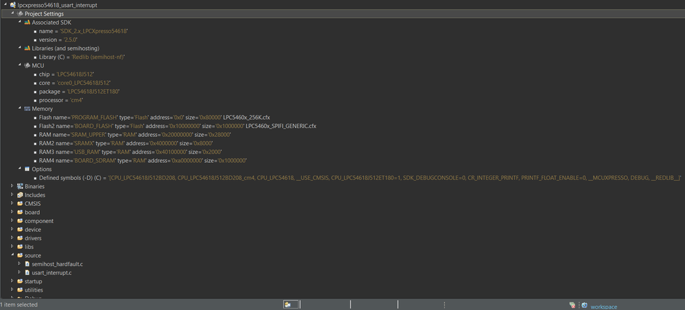

bshannon1
Thanks for your help with my issue. I followed your steps but I still have the same issues. The image below is my project settings.Capture.PNG

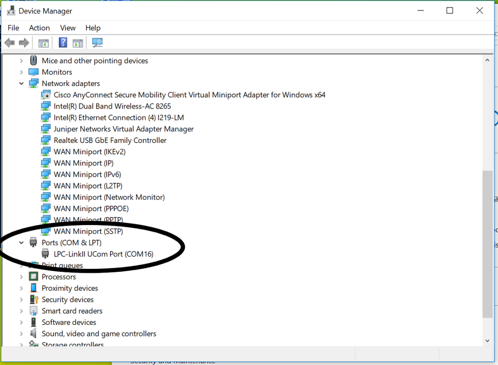

xiangjun_rong
Can you see the virtual COM number which is enumerated by PC?

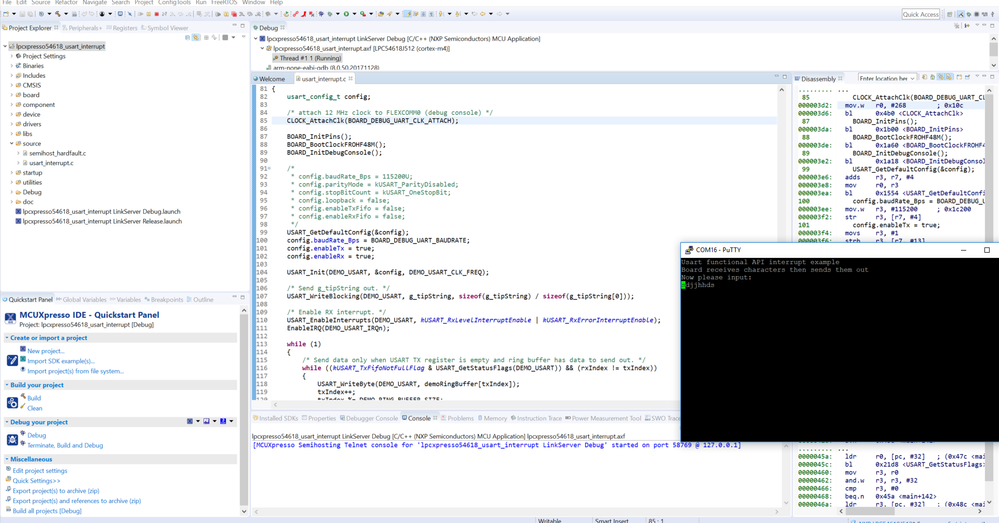

9,166 Views
bshannon1
Yes. I also tried using the serial terminal in the IDE and I am still experiencing the same issues.Capture3.PNG

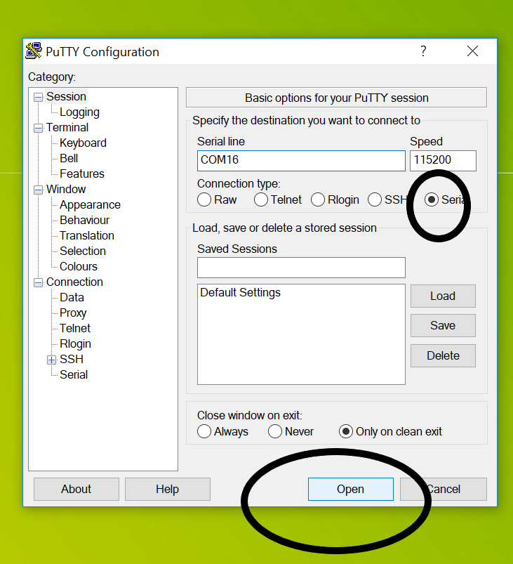

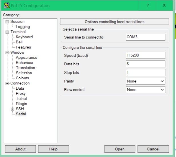

xiangjun_rong
Pls try to configure the PTTY tools as above.

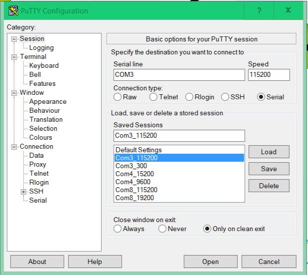

bshannon1
This is what I have done so far. I reinstalled the IDE and the device drivers. So now the com port has changed from COM8 to COM3. I tried using TeraTerm's serial terminal but I am still experiencing the same issue. I followed your steps to configure the PTTY tool as shown in the picture. However, I am still experiencing the same issues.puttyconfig.jpgputtyconfig2.jpg
