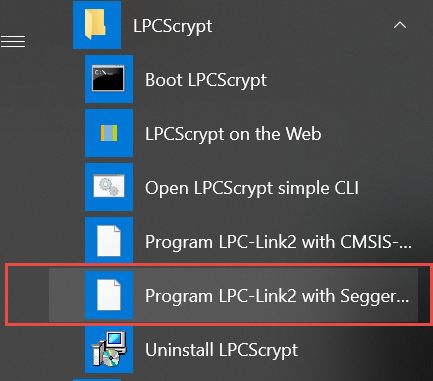

I suggest you follow this thread to update the on board debug firmware
LPC54608 board doesnt see any debug probes
If CMSIS-DAP can't work for you, try J-link instead.
When test the connection, create a new project under a NEW workspace.  see how it works.

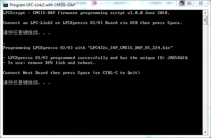

      Thank you for your reply. I still can not get the lpc-lin2 work ,i tried I tried the method you gave step by step ,i think i have programmed  LPC-LINK2 with CMSIS-DAP:lpc-link2_programmed.JPG

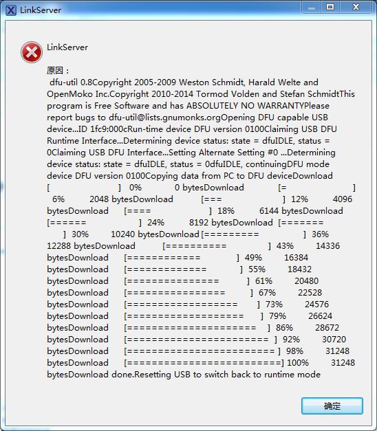

After that ,i remove jp5 and reboot the board, the Control Panel\Hardware and Sound\Devices and Printers of my PC is as follows:捕获.JPG.I create a new project in MCUXpresso IDE and try to debug it,it shows "No probes found".no probes.JPG
i tried J-link,it couldn't work either.What can i do now?

Did you try Segger J-Link connection?
If both of the connection can not work on your computer, create a new project in an new workspace on another computer. see how it works.
