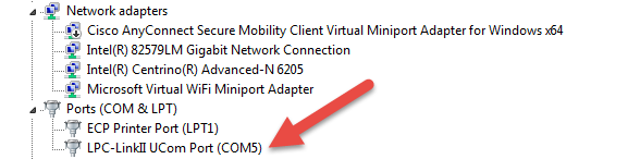

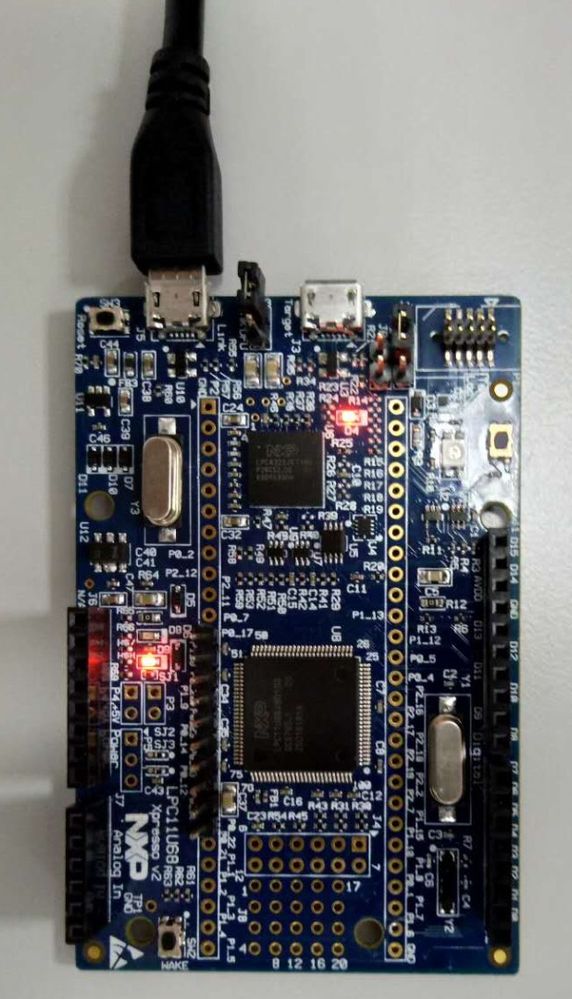

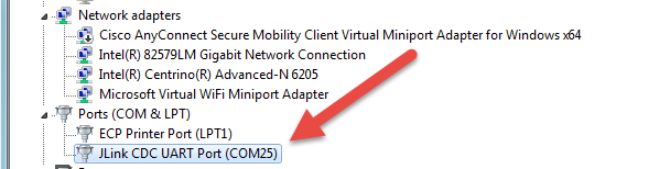

Hi Mark Johnson,
Thanks for your reply.
In my testing, the LPCXpresso11U68 board is able to be enumerated as a HID+CDC composite device no matter be programmed with CMSIS-DAP or J-Link firmware when it connects the PC host.
Fig 1
Fig 2
Fig 3
