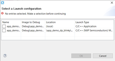

I am trying to run some example projects on the NHS3152 NFC Tag, but the following error keep preventing me from uploading a built project onto my board:
When I proceed (clicking OK) I have the choice of the debugger I want to use :
Both of them have the same error:
I can't seems to find the source of the problem, any help is welcome.

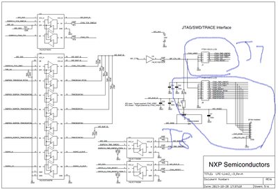

I have not the schematics of the NHS3152 demo kit, I attach the page of LPC-Link 2 schematics, you have to connect the J7(10 pins) or J8(20 pins) of LPC-link 2 to the SWD connector of NHS3152 demo board. If you close JP2, the NHS3152 demo kit will get power from LPC-LINK 2 board.
I suppose that the JP1 should be closed for LPC-link 2 board, pls have a try.
XiangJun Rong

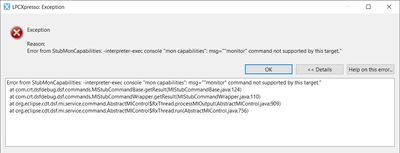

Thank you for your time. I tried debugging with JP1 shorted like you suggested. For the C/C++ Application Debug I have the same result. But, when I use the C/C++ (NXP Semiconductors MCU Application Debug I have a new error:
Pel_0-1636476897523.pngPel_0-1636476897523.png  Pel_1-1636476918285.pngPel_1-1636476918285.png
I thinking that maybe my board has some functions disable, but don't know how to make sure.

I think that the  LPC-Link 2 device configuration is okay. It appears that the Cortex-M0 of  NHS31xx has response.
Pls refer to the ticket:
https://community.nxp.com/t5/LPC-Microcontrollers/NHS3152-Program-will-only-run-while-connected-to-L...

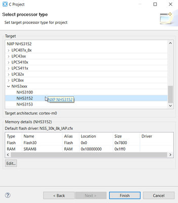

Everything seems to indicate that the NHS3152 is supported by the IDE.
Here is two examples:
MCU settings
Creating a new project
Regards.
