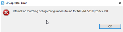

Hello NXP Community,
I am trying to run some example projects on the NHS3152 NFC Tag, but the following error keep preventing me from uploading a built project onto my board:
When I proceed (clicking OK) I have the choice of the debugger I want to use :
Both of them have the same error:
I can't seems to find the source of the problem, any help is welcome.

Which debug probe are you using?
6,249件の閲覧回数
Pel
I'm using the LPC-Link 2. (With the connection LPC-Link 2 J7 -to- NHS3135 demotkit J2).

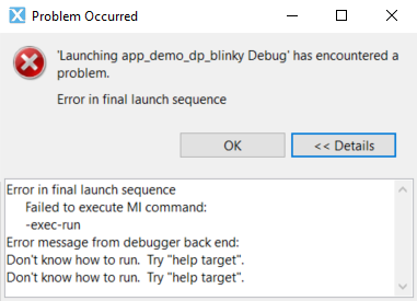

Hi XiangJun,
Thank you for your time. I tried debugging with JP1 shorted like you suggested. For the C/C++ Application Debug I have the same result. But, when I use the C/C++ (NXP Semiconductors MCU Application Debug I have a new error:
Pel_0-1636476897523.pngPel_0-1636476897523.png  Pel_1-1636476918285.pngPel_1-1636476918285.png
I thinking that maybe my board has some functions disable, but don't know how to make sure.

Pel
After reading and researching a bit I managed to flash the NHS3152 chip on my board and the code seems to work fine (I uploaded demo_blinky and now the LED blink). But when I try to debug the demo_blinky project I still have the same errors as before.
Is this a normal behavior ? I can flash the code on the chip, but can't debug it.
Regards.

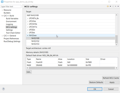

Pel
Everything seems to indicate that the NHS3152 is supported by the IDE.
Here is two examples:
MCU settings
Creating a new project
