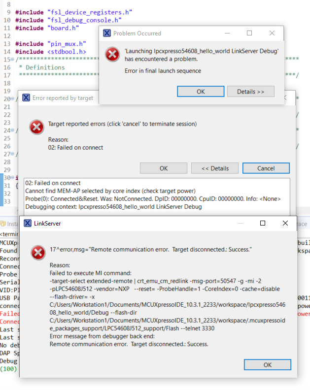

When trying to debug using link 2 probe (link server) this error occurs
Error in final launch sequence
Failed to execute MI command:
-target-select extended-remote | crt_emu_cm_redlink -msg-port=54569 -g -mi -2 -pLPC54608J512 -vendor=NXP --reset= -ProbeHandle=1 -CoreIndex=0 -cache=disable --flash-driver= -x C:/Users/Workstation1/Documents/MCUXpressoIDE_10.3.1_2233/workspace/lpcxpresso54608_hello_world/Debug --flash-dir C:/Users/Workstation1/Documents/MCUXpressoIDE_10.3.1_2233/workspace/.mcuxpressoide_packages_support/LPC54608J512_support/Flash --telnet 3330
Error message from debugger back end:
Remote communication error. Target disconnected.: Success.

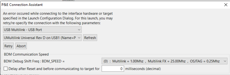

When trying to debug using PE Multi link this error occurs :
Error in services launch sequence
PEmicro GDB Launch Failure : The GDB Server was not able to establish a connection to the target processor. Please check your connections and power. Verify that the launch settings in the Debug Configuration are accurate.

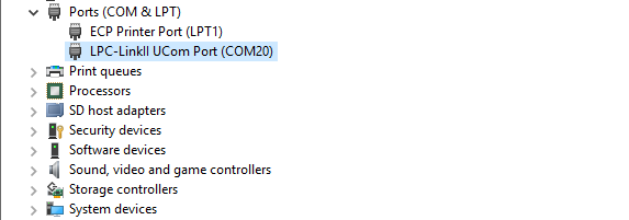

Can you please show me what Device Manager is showing? Or if the device is even being recognized by your computer?
It should look something like this:
Sebastian
5,470 Views
yashbohra80
Hi Sebastian,
The device is being recognized as port in device manager same as shown above.

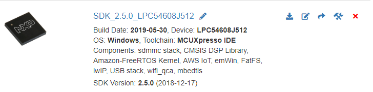

  • First of all, I redownloaded the latest SDK version for the LPC54608 MCU from our website and tried programming and debugging it again. The version of the SDK I downloaded was this one:

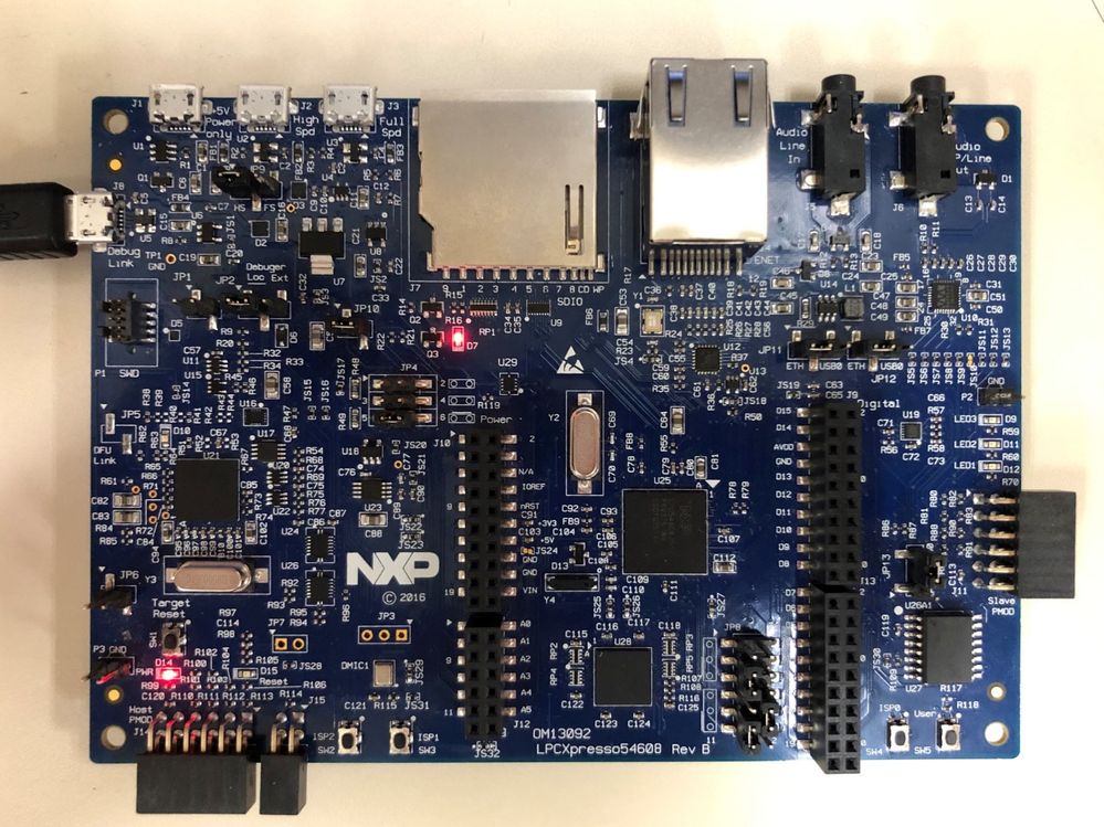

  • For programming and debugging the board, I used the following jumper and USB cable configuration:
  • I used the LED Blinky example code to test, I built the program, and then I pressed the Debug button on MCUXpresso to download the code to the MCU. The debug mode was enabled correctly and I could freely control it:
Could you please compare your board to the picture I attached to the post? Maybe some jumpers on your board are not being configured correctly.

Thank you for your reply , I did the same connections as shown above but after debugging I am getting these error messages shown above.

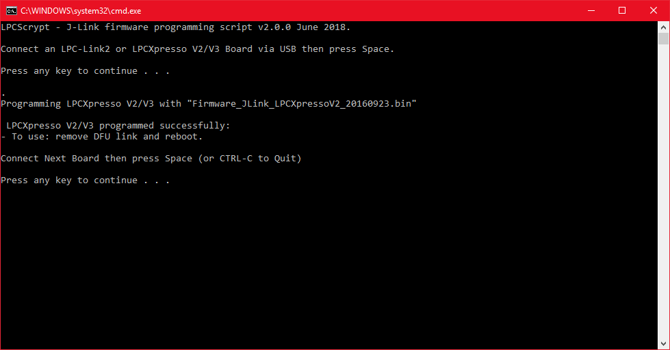

Install them, and then please try reinstalling the included drivers in the "Drivers" folder in your install location (by default it should be C:\nxp\LPCScrypt_2.1.0_842). After doing that, please go into the scripts folder and launch the "program_JLINK.cmd" script.
On your board, please make sure the DFU link jumper (JP5) is shorted, and then connect your board, then press any key. Your board will now have Jlink installed. Remove the DFU Link jumper (JP5) and restart your board.

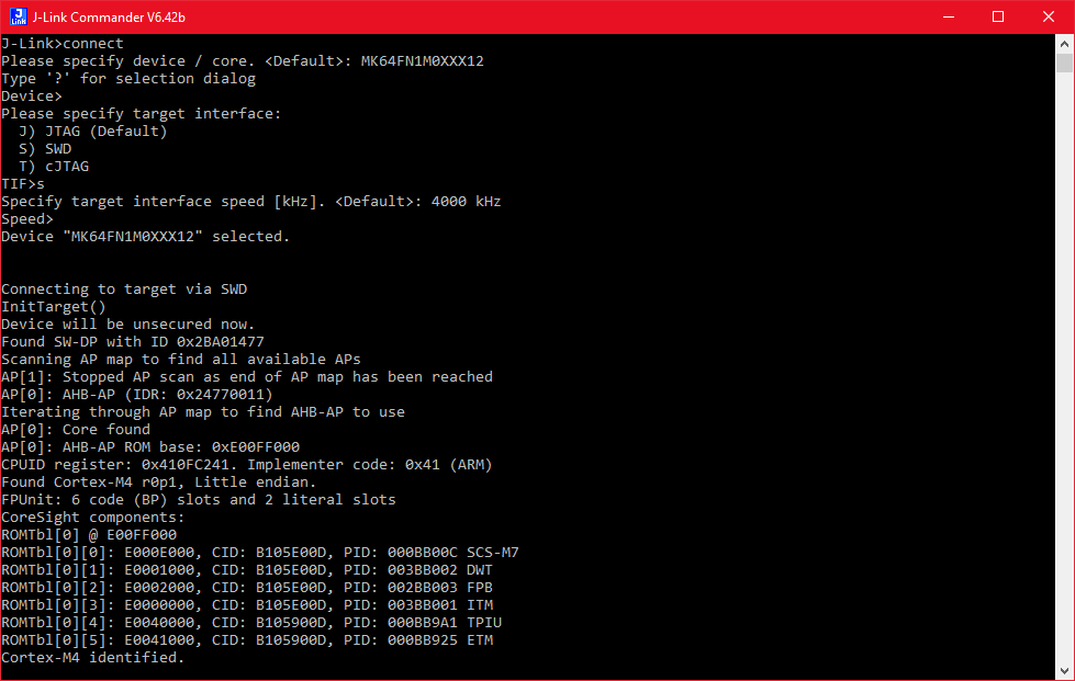

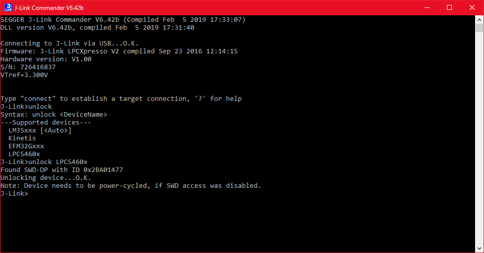

After doing that, launch Jlink Commander and type unlock LPC5460x:
After doing that, try connecting to the device by typing "connect", pressing enter and selecting SWD as the Target Interface, and after pressing enter one more time you should see something similar to the following screenshot:

I tried using Link2 Debug Probe and an external debug probe(PE Micro) both and i kept j1 open in these cases. But still the same error
