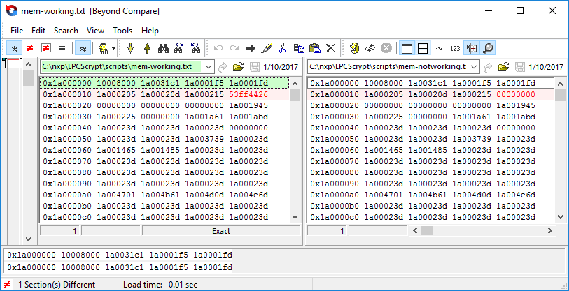

At that point I was able to follow your instructions and load the image to the target using LPCScrypt.  But the image still did not run. When I used the LPCXpersso Ide to program the bin file to BankA it loads and runs without difficulty.  But when I used LPCScrypt the program loads fine but does not run.
I then compared the contents of the flash (using LPCScrypt memDisplay command) and found that the is a small difference between the two loading techniques.  At memory location 0x1a00001c  (around the vectors location) the contents of the flash are not the same even though the same bin file was used to program the device.
When using LPCXpresso the value of that memory location is 0x53ff4426 but when I use LPCScrypt the value is 0x00000000.  I manually updated the contents of  0x1a00001c to  0x53ff4426 ( using LPCScrypt flashSet command) and the program began to run.  That is the only location where there was a discrepancy.
Why and what is there a different between programming with LPCXpresso and LPCSrypt.
How can we correct this?
