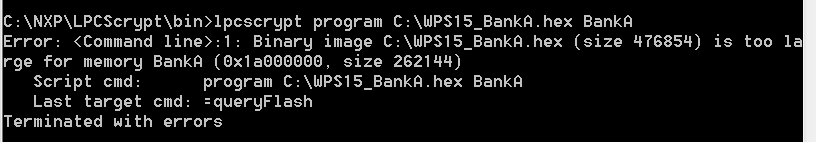

I have problem with programming LPC1853 via USB.
My environment : Keil uVision, LPCScrypt 1.8.0, srec_cat (SRecord).
   In my HW I have LPC1853 and external SPIFI flash. I would like to exchange code via USB0.
LPCScrypt can't program all memories (two internal memory Banks and ext. flash) . I need to split one final hex file into 4 small peaces - BankA, BankB, SPIFI, EEPROM.
   Keil recommended to use srec_cat tool to do it. It works fine. I can program via LPCScypt (USB0) SPIFI and EEPROM, but I have a problem with internal flash Banks.
LPCSrypt shows error :
But I tried to program the same hex (WPS15_BankA.hex) via J-Flash (and JTAG) and it works fine. It adds checksum for this bank. And after programming a both banks via J-Flash a device works fine.
LPCScrypt has problem with the size, although I divided internal flash according to the instructions on the 2 banks (each 256kB).

jeremyzhou
Hi Mariusz Wlodarczyk,
LPCScrypt can be used to download either plain binary files or binary files wrapped with a header, and other format files are not available.
Ping
1,576 Views
converse
Senior Contributor V
Looks like you have a HEX file and not a BINARY file... A hex file is an ascii encoding of binary data. A binary file is just the exact binary data you want written to the memory. LPCScrypt needs binary data, not ascii.
