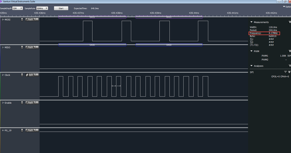

   I have test the lpcopen spi master in my LPCXpresso 54102 board, the GPIO PIO0_19 can track the SPI wave correctly.
   This is my logic analyzer SPI wave
Clock rate is 4Mhz.
My modified code is lpc5410x_xpresso54102_keil_iar_v3.03.000_16, project periph_spi_sm_int.

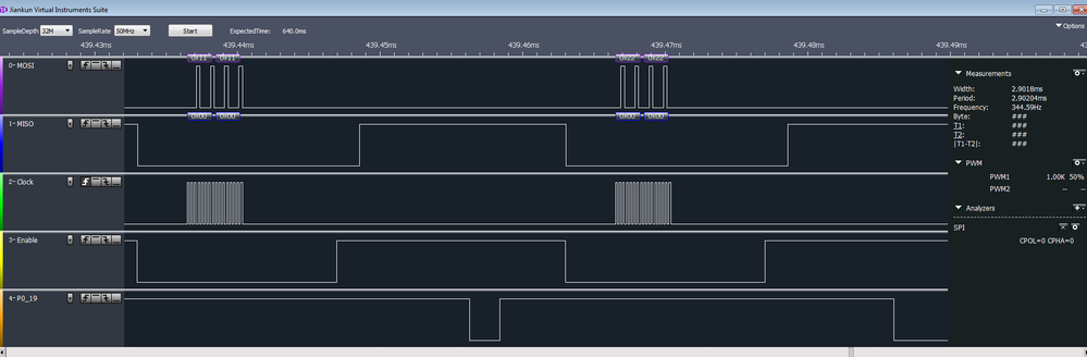

6,992 Views
kerryzhou
Hi Patroklos Anagnostou,
   Could you please also attach your SPI wave? Just for analysis.
Kerry
6,986 Views
selportion
Yes, please find attached the case with spi clock 1Mhz and the case with 100kHz.
The blue trace is the gpio that tracks the code execution flow, the green is the slave select, the yellow is clock and the pink is data. It seems to me that the spi functions are not blocking and the state is 'DONE' even during the transfer. Also in the case of 1Mhz the EOF flag to pulse the SS between byte/words is ignored.
