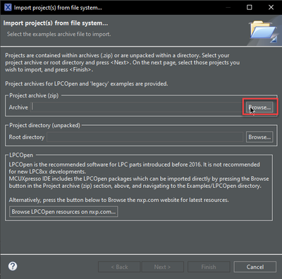

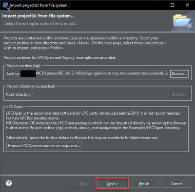

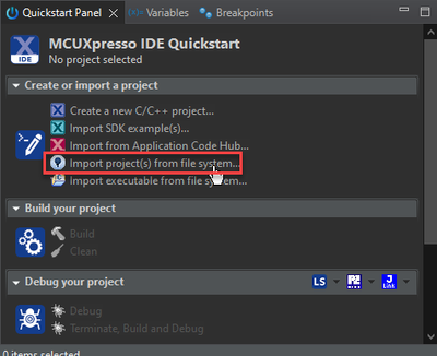

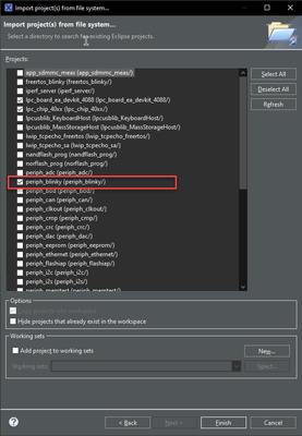

I will use MCUxpresso to develop LPC micrcontroller.
I has been installed the IDE, but I cannot download LPCOpen for LPC4078 now.
Who can help to resolve the problem?
1,731件の閲覧回数
Habib_MS

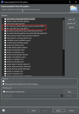

Hello @Hamish1,
You can follow these steps to import LPCOPEN examples in MCUxpresso version 24.12:
In the QuickStart Panel click on import project(s) from file system:
Click on browse:
Select LPCOpen and select your board. Once you have selected your board, click next.
In order for it to compile correctly you have to import at least these two examples:
Also, the example you will use:
Click finish.
Also, if you experience any issue, does not hesitate to let me know.
Habib

Hello @Hamish1,
Click on browse:
Click finish.
Habib

Hamish1
Thank you for your help. Your answer helped me quickly understand the solution and solve the problem.
