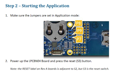

I just saw that the LPC8N4 default application needs to receive the same reset signal once the MCU is powered up. LPC8N04: NFC Hands-on Lab Guide
Is this the expected behavior for every application loaded?
Is there a way to avoid the need of a reset signal once the MCU is powered?
Normally, you only do this to get the MCU into a specific mode, i.e. pull the mode pins to certain levels to get it into ISR mode (ROM bootloader).
If the board does not run after power-up, you might have a power supply issue. Which means, the power supply is not yet stable when the L-H transition at the reset pin occurs.
The most common method to correct this is to prolong the reset signal at power-up, in the simplest case with a RC element.

Hi @frank_m,
The RC solved the issue.
Thanks!
