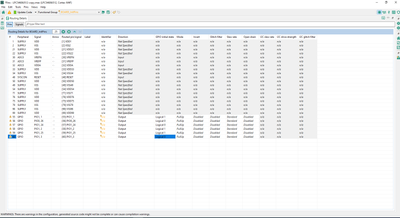

Can you tell me also how to modify a single bit of a register while debugging in MCUxpresso?
1,811 Views
PK_1114
Dear @tomato ,
Please Click on the View Menu and Select the Routing Details in that drop down. In that you can select the  GPIO state mauvely.
Thank You,
 B Pavan Kumar
