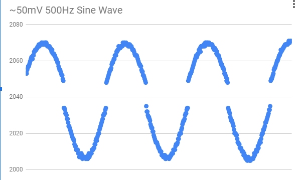

Has anyone else noticed a large discontinuity while using the LPC845 ADC near mid-value?  I am seeing a range of missing codes immediately below 2048 ticks.
I can replicate this on my own boards along with the LPCXpresso845MAX dev board using minimally modified example code.  By changing the adc_basic example to use ADC2 and connecting a bench supply with 2K/22K resistor divider to Analog header A0, I can replicate the issue by dialing the supply voltage.  Here are the missing code ranges I observe on my three LPCXpresso845MAX boards:
   2034-2047
   2037-2047
   2041-2047
The problem exists independent of sample rate and is present at much lower input impedances as well.  This is rather annoying for my application since I have bidirectional current sensors which idle at half ADC value.

ebucha
Xiangjun,
I've done a bit more testing to better quantify the problem.
First, I ran a quick test with a 500Hz ~50mV sine wave from a 50 ohm signal generator on my worst LPCXpresso845MAX board.  The sample plot makes it easy to visualize the gap in codes:
Second, I collected date codes and more precise code gap sizes for the LPC845 chips I am looking at:
LPCXpresso845MAX Boards:
Date CodeMissing Code Count
17-2713
17-279
17-447
My Custom Board:
17-4415
I'm seeing the problem in both batches of chips I have on hand.
Lastly, I ran a test over night with a source at 1.65V.  This results in readings toggling back and forth across the discontinuity due to noise.  Over many hours and millions of samples, not once did I see a missing code re-appear.
So to summarize:
  • Missing codes aren't dependent on source impedance (50ohm - 200kohm) or sample rate (4ksps - 1.2Msps)
  • ADC Calibration (or removal thereof)  doesn't impact the missing codes
  • The size of the code gap is consistent on a given chip at room temperature but varies chip-to-chip
  • The gap is much larger than the INL typical spec leads us to expect worst case
  • The missing codes never appear even with noise present in the signal
  • Values below the gap are still nicely linear - Actual voltage can be derived if the size of the code gap is known
Other engineers on my end are interested to see if the problem can be replicated.  We suspect an unexpected error term in the lower half of the successive approximation DAC or similar issue.
Evan Buchanan
