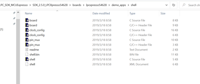

xiangjun_rong
I think you want to develop the shell like tools, so I suggest that you refer to the shell code in SDK package, but the shell code is only available for LPC54xxx, pls download the SDK package for LPC54628 from the link:
https://www.nxp.com/design/software/development-software/mcuxpresso-software-and-tools-/mcuxpresso-s...
check the directory:
Hope it can help you
