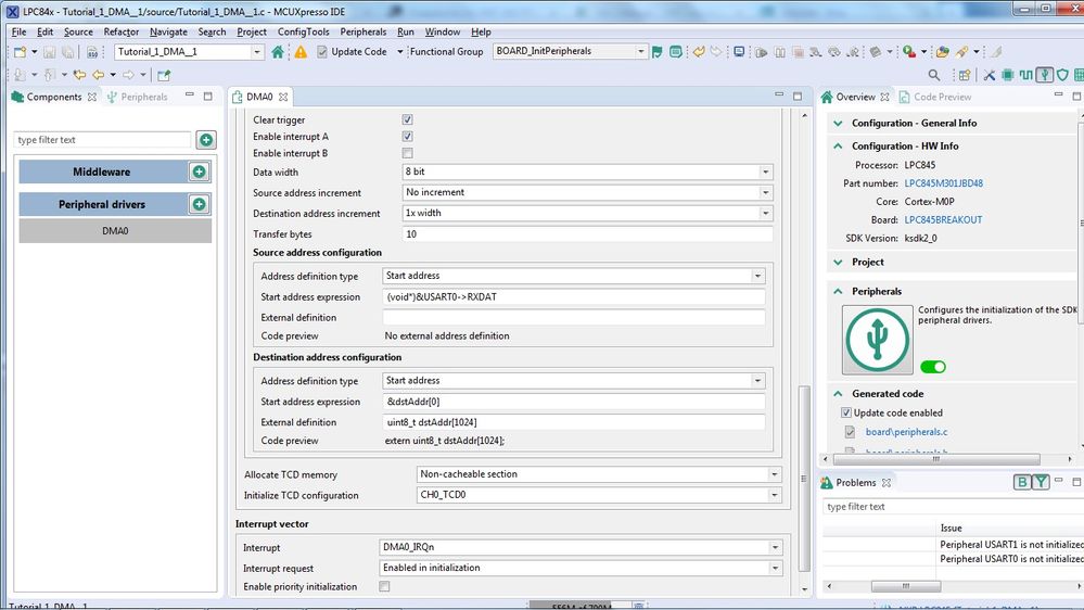

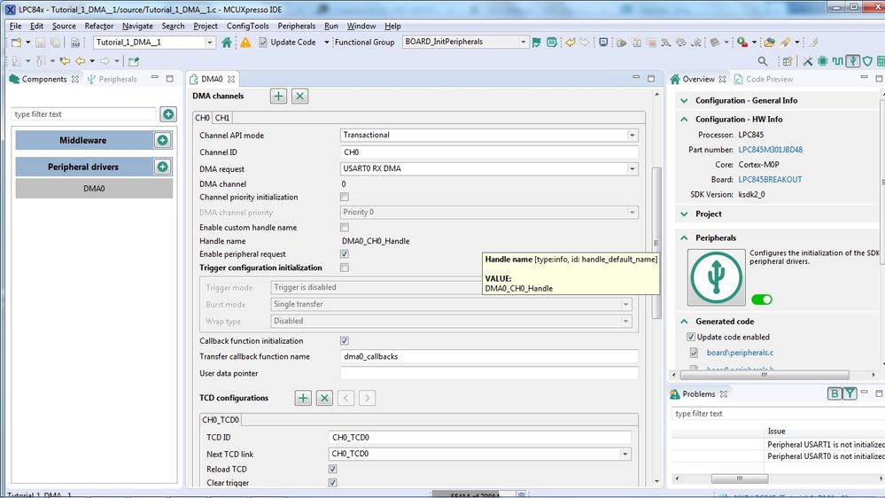

I want to receive 10 bytes by the serial port with the help of the DMA0 module, I attach the code and images of configuration.

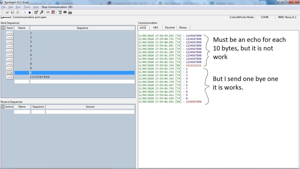

The problem is when I send the 10 bytes continuos I don't receive anything, But when I send one byte by  one it is ok. Is it correct the funcionality?

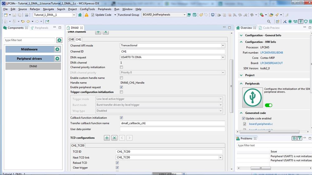

So I try to configurate other channel to do a echo, the other channel is CH1 (attached images of configuration). When I receive the 10 byte (one by one), active the transfer of the channel 1 to send data to the USART0->TXDAT, and it's work...
So the problem I guess it is only for the CHANNEL0 (that is for the receive data by DMA)
has someone an idea what it is the problem? because I tried some things but I didn't find the solution.

Arturo1901
Yes, the problem is the debugger, when you try to send or recive information with the virtual serial port using the DMA it is not going to work, so the serial port from the LPC845 it is working correctly, so if you do the same thing but with other serial port from LPC845 is going to work. You can try to connect a USB to SERIAL to the pines RX and TX from LPC845.
