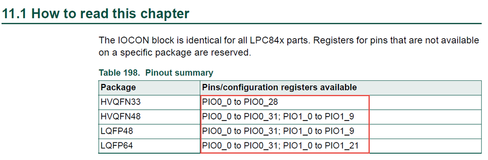

Hello guys,

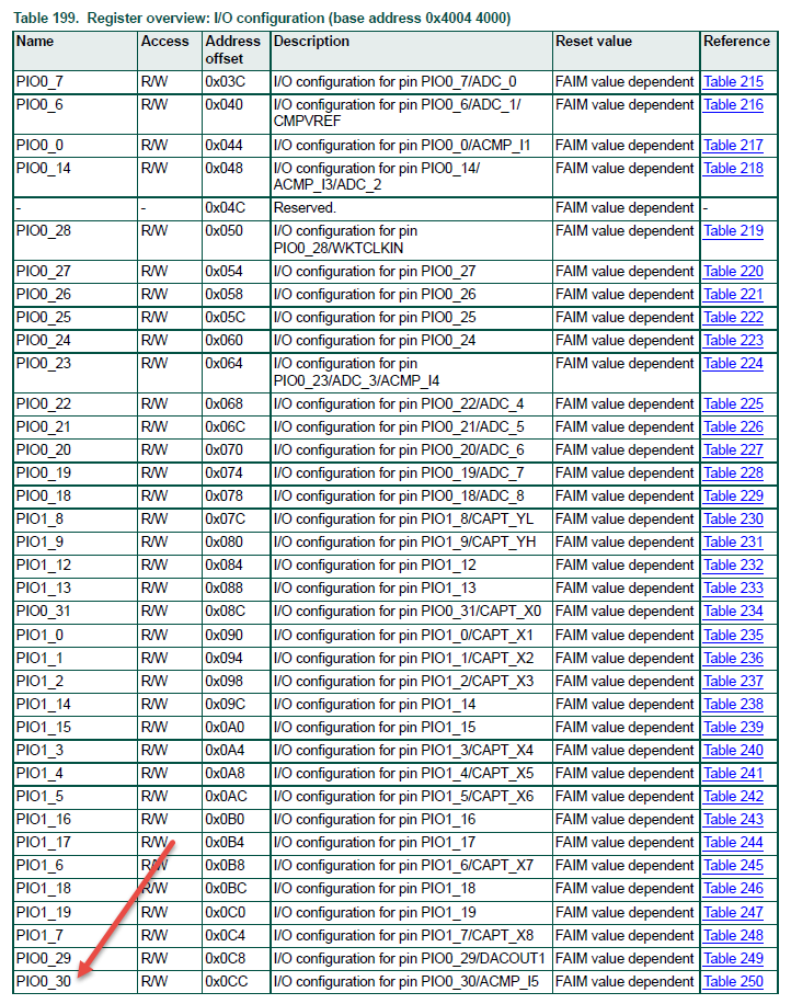

If I go to the LPC845 datasheet on page 8, fig. 5, the LQFP48 package has a pin number 42 which corresponds to PIO0_30. If I go to the LPC845 user guide in section 11.5 I/O configuration register description, I cannot find such a pin.
If I go to PIO1_30 in that same document I see a table name:
Table 250. PIO0_30 register (PIO0_30, address 0x4004 40CC) bit description
So which one is true? I'm a bit confused.
Thanks in advance,
L. B.

In section 11.5 I/O configuration register description of LPC845's user guide, the Table 199 contains the PIO0_30 actually.

OK, I see!
Can we say that the register PIO1_30 has the same structure of the bit fields as PIO0_30?
