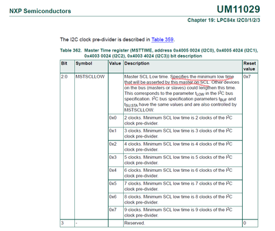

Hello, I am trying to configure I2C to work at 400kHz. I am using a logic analyzer at 8Ms/s to see SCL and SDA lanes.
Here is what datasheet says about I2C clock:
This is what I have configured:
MAIN_CLOCK=12MHz
CLKDIV=4
MSTIME=17 (High and low at 3 cycles)
This is what analyzer sees:
As we can see high and low times are uneven and frequency is not 400kHz
Why could this be happening?

As the following Figure, both the MSTSCLLOW and MSTSCLHIGH bits only specify the minimum time of the SCL low and high time, there is internal rule to define the concrete time.'
Hope it can help you
XiangJun Rong

Hello, thanks for answering. I get less than 400kHz either with or without another device connected to I2C lane. Is this still normal?
1,821 Views
xiangjun_rong
I suppose it is normal, the I2C clock is not related with if the I2C slave device is connected. But the I2C slave device can provide the ACK signal when the master send the slave address and direction, so I suggest you connect I2C slave device when you test I2C function.
