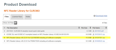

At first, thank you very much for support. I had already read the reference you have suggested to me and already downloaded the "NFC Reader Library" (for example to burn onto the microntroller of  CLEV6630B board in a second time). In effect, my question was "What is the LPC FW indicated at page 14 of AN11022"??? Is it included in the NFC Reader Library (where? which one?) or have I to download it apart from??? I need your support again, sorry.

NFC reader library includes SW297847.zip。
the default demo is one of the demo code based on different batch. I suggest you use NfcrdlibEx1_BasicDiscoveryLoop

ZhangJennie
Hi Predator72
Sorry. my typo. it should be SW297851.zip
It's inside NFC Reader Library as you already have. download it you will see
