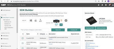

Thank you. How can I install the SDK files ?
It is not a uVision software pack. I made sure that 'Keil' was selected.

ZhangJennie
Under SDK there is Getting Started with MCUXpresso SDK.pdf
Have a look on this chapter: Run a demo using Keil® MDK/μVision
This will tell you how to run a Keil demo.
Have a nice day,
Jun Zhang

KoComputes
Thank you. I wasn't aware that guides for Keil are part of the MCUXpresso SDK documentation.
I got the examples working. Nice, very helpful.
Regarding the second part of my question: I will go with the fsl_ drivers, the CMSIS software pack, and study CMSIS and the SDK docs first.

ZhangJennie
we have MCUXpresso SDK for Keil.
Here is the download site: https://mcuxpresso.nxp.com/en/builder?hw=LPC844
Have a nice day
