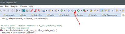

I think the Eclipse debug interface is unneccessary difficult and awkward.
Have you started the debuuging properly ?
First, select the debug dropdown menu, as shown in the snapshot.
From the menu, select "Debug as...".
Then, select the proper debug adapter. In your case, probably "MCUXpresso IDE LinkServer (CMSIS-DAP)".

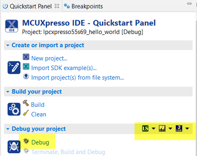

Hello Frank,
You can directly choose debug way refer to your debug probe under "Quickstart Panel",
or click "Debug" button and pressing Shift button on your PC, IDE will search the debug probe automatically.
