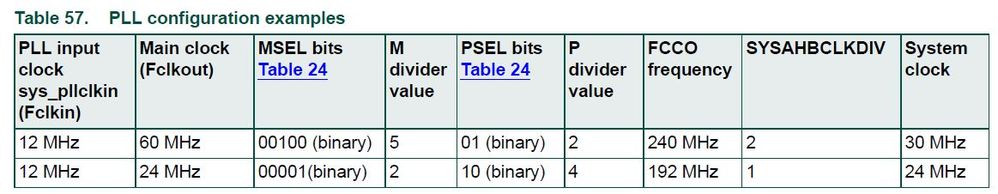

//Configure PLL - 60MHz Main CLK - 30MHz System CLK
SYSCON->SYSPLLCTRL |= SYSCON_SYSPLLCTRL_MSEL(4) | SYSCON_SYSPLLCTRL_PSEL(1);
//Set System clk divider
SYSCON->SYSAHBCLKDIV = 2;

I've also tried with the internal oscillator, and it yields the same result. If I however go down to 24MHz, everything seems to work as intended, and across temperature variations too. In my case I don't need it to run at the full 30MHz,  but I was curious why it didn't work, so I thought I would ask here.

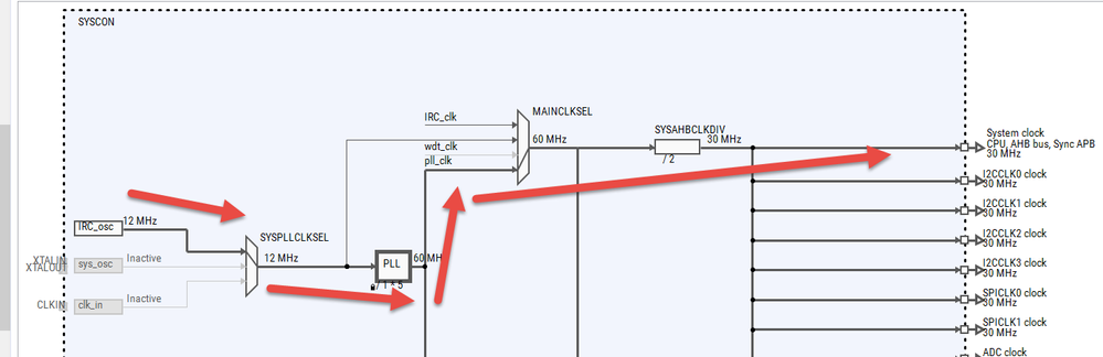

Hi Kenneth Johansen
I tested your issue on my LPC824 demo board.
Clock path:
my testing code is attached. the code is to blink on board LED D1.
the board is running with this code without any issue. I reset board for 10 times, the board still function well.
I suggest you refer or test my demo, if you can find any issue on your code.

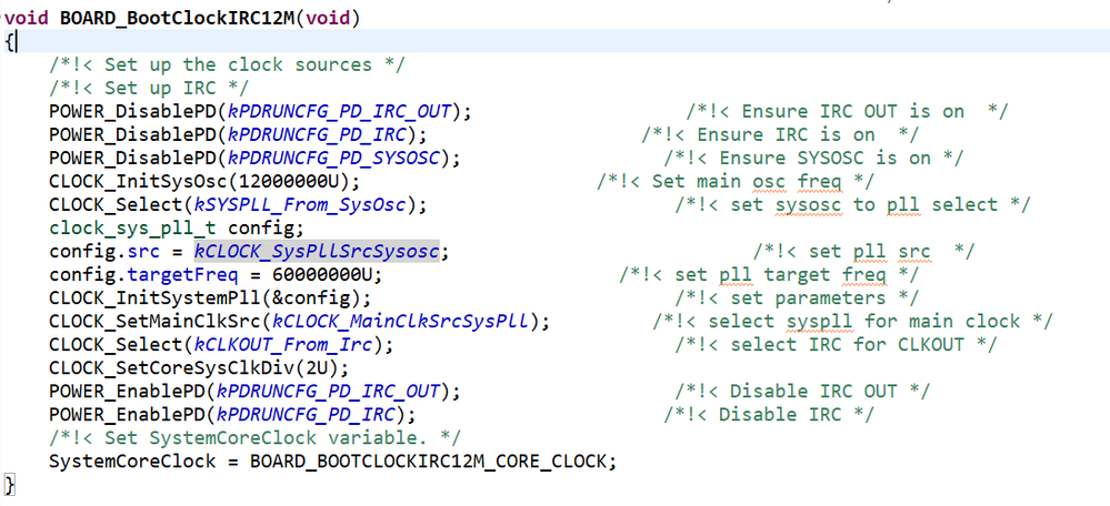

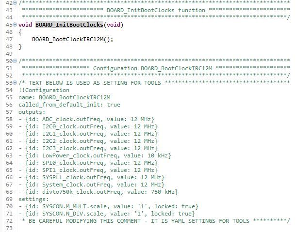

kenneth880320
Hey Jun
I've taken a look at your provided code, and I don't see where you setup the frequency of the board to run 30MHz? In my SDK, calling BOARD_InitBootClocks() will only setup the board to run at 12MHz and not 30MHz as seen below:
Also, I can get my code to run and lock the PLL, but as soon as I raise the temperature, and then reset the board, it will stop being able to lock the PLL. My problem is both a factor of resetting and temperature, so you can't just test it with a board without increasing the temperature and then trying to reset.

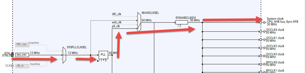

ZhangJennie
Kenneth,
This time, I test board with external system osc
In my attached demo, CLOCK_SetCoreSysClkDiv(2U) is to set SYSAHBCLKDIV as 2, thus system clock = 60M/2=30MHZ
I tested code with 35-40c environment, no reset issue.
I suggest you test my code with two more other board, if this problem is same? can you also test it with nxp demo board?
