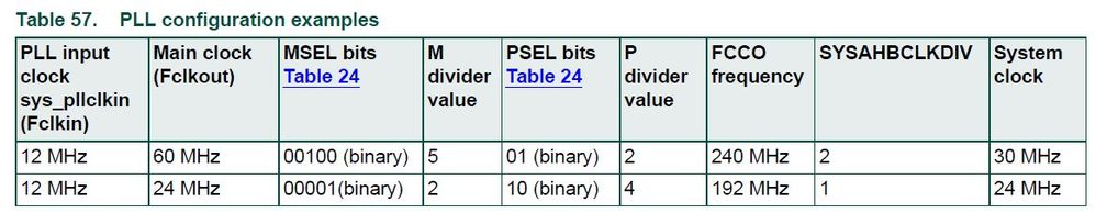

I'm working on a project where I just happened to run a LPC824 at 30MHz with an external 12MHz crystal. According to the user manual (UM10800) this setup is supported, and it does seem to work "sometimes".
I say sometimes because as soon as the micro controller becomes just slightly warm (Only talking about 35c here) and you reset it, it wont lock the PLL anymore and it gets stuck trying to lock.
I've included my code below, written in MCUXpresso with the SDK for the LPC824, just in case it is me doing something wrong:

//Configure PLL - 60MHz Main CLK - 30MHz System CLK
SYSCON->SYSPLLCTRL |= SYSCON_SYSPLLCTRL_MSEL(4) | SYSCON_SYSPLLCTRL_PSEL(1);

I've also tried with the internal oscillator, and it yields the same result. If I however go down to 24MHz, everything seems to work as intended, and across temperature variations too. In my case I don't need it to run at the full 30MHz,  but I was curious why it didn't work, so I thought I would ask here.

I've taken a look at your provided code, and I don't see where you setup the frequency of the board to run 30MHz? In my SDK, calling BOARD_InitBootClocks() will only setup the board to run at 12MHz and not 30MHz as seen below:
Also, I can get my code to run and lock the PLL, but as soon as I raise the temperature, and then reset the board, it will stop being able to lock the PLL. My problem is both a factor of resetting and temperature, so you can't just test it with a board without increasing the temperature and then trying to reset.

In my attached demo, CLOCK_SetCoreSysClkDiv(2U) is to set SYSAHBCLKDIV as 2, thus system clock = 60M/2=30MHZ
