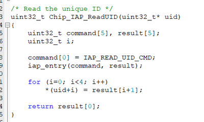

On both my 824 and 845 projects, I have:
It returns 4 x 32 bit for the ID
