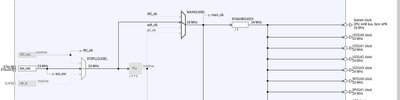

Hello, having trouble setting up to run off an external oscillator 24MHz, used MCUXpresso Config Tools v11 to produce some code but I can't use it directly as the project was generated with V1 SDKs so been trying to map it across with little success. The datasheet and user manual are unclear on if the PPL needs to be setup if you are just pointing the main clock to the input?

This code now works, issue put down to GPIO pinmode, and active pull up or pull downs?

Thanks Julian,
I can't update the SDK as this project is based on an existing one with ten's of millions of service hours and industry approvals.
I don't actually need the PLL as I have a 24MHz external oscillator, but it looks like you can only route this in the 824 as PLLIN (the 844 & 845 have exeocs linkage), so my question was can you use PLLIN without the PLL being set up?
 In effect I want this
As that did not seem to work, I thought maybe the PLL needs to be active to use PLLIN?
