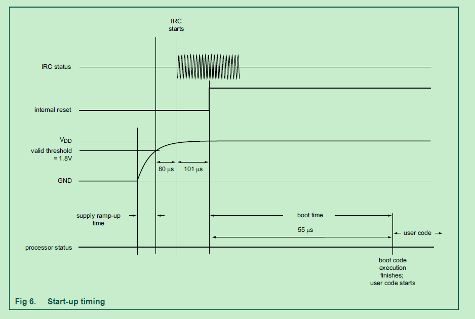

Hi , I am using LPC824, In User Manual (UM10800) it is mentioned the startup time from VDD to "user code " is 256us but i am getting around 600us ,In my code i initialized SystemCoreClockUpdate();,Chip_GPIO_Init(LPC_GPIO_PORT); and made gpio output low . can someone help me on this issue to achieve 256us as per datasheet .Thank you

Hi Avinash Puli,
   Agree with Marc, it is not the problem, just caused by your measure method.
    SystemCoreClockUpdate();,Chip_GPIO_Init(LPC_GPIO_PORT); already your own user code, it is not include in the startup time.
   Your own user code also caused a lot of time.
Wish it helps you!
Kerry
1,599 Views
marcprager
A fair measurement in my opinion would be performing a GPIO without changing clocks.
The initialization you do is already 'your' user code ;-)
