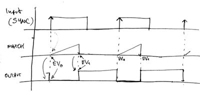

Right after clearing the CTRL::HOLD bit flag (in order to start the timer), the CTRL::STOP bit flag is automatically set, and there's no way to clear it!

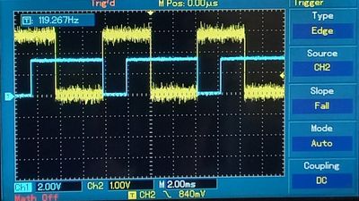

This same application runs nicely on a LPC812MAX board:
A synchrony signal is shown on yellow color, while an output signal is shown in blue color. What I'm trying to achieve is (which I've already done it in the LPC812 uC):

Now, what's the problem with the LPC824? Let me show you the last instruction after the timer has been configured:
//Chip_SCT_ClearControl( LPC_SCT, SCT_CTRL_HALT_L ); // both instructions are the same
LPC_SCT->CTRL_U &= ~( 4 );
After executing this instruction the CTRL::STOP bit flag is set:
Captura de pantalla de 2022-12-04 19-48-15.pngCaptura de pantalla de 2022-12-04 19-48-15.png
And none of these instructions are capable of clearing the STOP flag:
Chip_SCT_ClearControl( LPC_SCT, SCT_CTRL_STOP_L );
LPC_SCT->CTRL_U &= ~(0x2);
At the end of this post I'll show you the complete code for such configuration; but before in doing so, I found that if I comment this next instruction out, which stops the timer in EVENT1, then the STOP flag is not set; however, my application is still failing at its purpose:
LPC_SCT->STOP_U = SCT_EVT_1;
Thank you in advance. Any hint or suggestion is appreciated.
