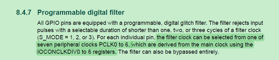

Digital glitch filtering on GPIO inputs it's a nice feature on LPC824.
It's possible to have'it active while using power down mode?
I noticed that once enabled, part will enter into power down but won't be able to wake-up anymore. Probably the clock of digital sampler is turned off (most likely) and the edge that suppose to arrive as wake-up source is not catch.

1.  It's possible to have  digital glitch filtering active while using power down mode?
    No, as you know, the digital glitch filtering should use the filter clock, and the filter clock is selected from the peripheral clocks, you can get it from the user manual:

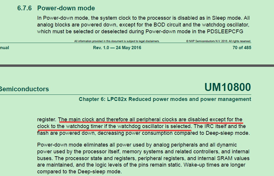

But in the power down mode:
  You can get that all the peripheral clocks are disabled except for the watchdog timer.
  So, you can't use the digital glitch in power down mode, and you test already verify it.

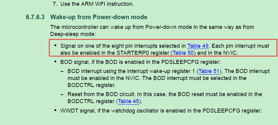

2. it's possible to just wake-up the part and NOT jump to interrupt vector?
  From low power wake-up conditions in the flowing picture:
You can get that you must enable the NVIC.
  But in the Deep power-down mode,  you can wake up on a pulse on the WAKEUP pin, and don't need to use interrupt.

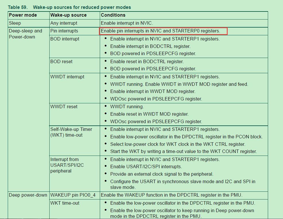

Hello Jingjing,
I'm not able to wake-up if NVIC entry PININTx is not enabled.
So I guess wake-up glue is tied on NVIC (after) and not on peripheral flag to NVIC (just before it).
My use-case don't need that jump. Just wake-up and continue (resume) from that point.

    NVIC is must enabled for waking up from power-down mode:
  Actually, when the Pin interrupt happens, you also need to clear the pin interrupt flag in the according interrupt.
  After the interrupt is exit, then the code will run from the position which below entering the Power down mode.
  Enable NVIC to wakeup the power down mode is the wakeup mechanism.
