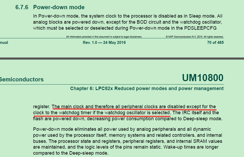

1.  It's possible to have  digital glitch filtering active while using power down mode?
    No, as you know, the digital glitch filtering should use the filter clock, and the filter clock is selected from the peripheral clocks, you can get it from the user manual:
But in the power down mode:
  You can get that all the peripheral clocks are disabled except for the watchdog timer.
  So, you can't use the digital glitch in power down mode, and you test already verify it.
