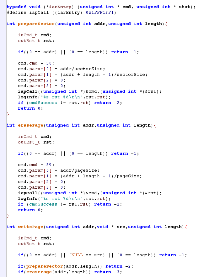

caibai
hi,i'm stuck in when erase a page by iapCall, code as follow
i just call
    writePage(0x7C00,buf,4);
and in writePage  call prepareSector return success,but call erasePage will be stuck in,
how to fix it,does IRC must enable?

kerryzhou
Hi Cai bai,
   This is my code for your reference:
