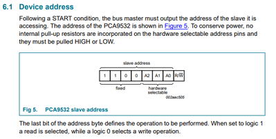

I can not find out the data sheet of PCA5532, but I found out PCA9532 from the link:
https://www.nxp.com.cn/docs/en/data-sheet/PCA9532.pdf
If the A2/A1/A0 are 000 in binary, you can set the address as 0xC0>>1 or 0x60 when you call the I2C_MasterStart(I2C_Type *base, uint8_t address, i2c_direction_t direction)
Hope it can help you
XiangJun Rong
