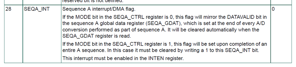

I have a problem using the sequences of the LPC822.
When I select multiple channels to be read in a sequence and I select single step everything is fine and the correct values are read. However when disabling single step one channel (10)  gives me wrong values. The incorrect value is consistent though, it wil always be the same incorrect value.
Anyone got any idea what this could possibly be? Source code down below. A convertion is triggered manually by the MRT every 100ms.
Thx,
Alexander

Hi Alexander,
you have chosen to generate ADC interrupts at the end of every sequence of conversions.
In this case you need to clear the SEQA_INT flag by software in the interrupt handler.
You need to set :smileyalert: bit 28 in the LPC_ADC->FLAGS register.
