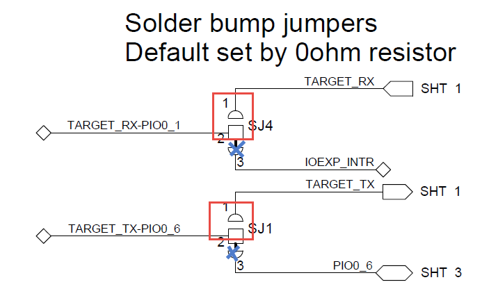

jeremyzhou
Hi Ashok Ra,
I'd like to suggest that you need to do some hardware circuit modification as the figure shows and give a try again.
TIC

ashokfair
HI Zhou,
Thank you! But with my same LPC MAX board previously 115200 baudrate works with LPCOpen8xx Libraries.
4,737 Views
