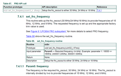

 How about use the  API of  set_fro_frequency :

Alice,
Thanks for the reply.  I did see that API of  set_fro_frequency() but it says pretty clearly that the options for frequency parameter are only: 18000 => 18MHz, 24000=>24Mhz, 30000=>30Mhz.
But since you (NXP TechSupport) suggested that I could use this to trim the frequency, I gave it a try.
I hacked the fsl_clock.c and changed:
/*! brief Set FRO oscillator output frequency.
 *  Initialize the FRO clock to given frequency (18, 24 or 30 MHz).
 * param freq, please reference clock_fro_osc_freq_t definition, frequency must be one of 18000, 24000 or 30000 KHz.
void CLOCK_SetFroOscFreq(clock_fro_osc_freq_t freq)
    g_Fro_Osc_Freq = (uint32_t)freq * 1000UL;
    LPC_PWRD_API->set_fro_frequency(30100000UL); //(uint32_t)freq); -HACKING!
The result is that the clock is running at 24MHz (not the expected 30.1MHz).  This is confirmed by my FreeRTOS xTaskGetTickCount() counting at 12.5ms instead of 10ms.  And the serial baud is lowered to 93000bps from 115200, a -20% decrease.
I also tried set_fro_frequncy(29900000UL), set_fro_frequncy(30001000UL), and set_fro_frequncy(29000000UL).  They all result in a 24MHz clock.  (I guess 24MHz is the default, so the API just silently fails and keeps the default?)
So as I had expected, the API is not allowing to trim the clock.  But I wasted some more of my time to confirm.
