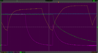

Traces
The below trace shows a test run from power-on. The fault can be seen where PIO0_12 (ISP) becomes a sink. The device traps into ISP mode and stops on the next reset.
Figure 1: CH1 = PIO0_5 (RESET), CH2 = PIO0_2 (TMS), CH3 = PIO0_3 (TCK), CH4 = PIO0_12 (ISP)

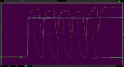

The next trace shows the same failure mode with a narrower time base. The accelerated RESET rise after the fault is normal and caused by a capacitive coupling to PIO0_22 which has started sourcing after the fault.
Figure 2: 500µs time-base
