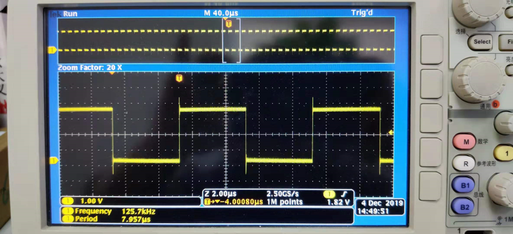

Hi Martin Fierz,
Thanks for your reply.
I've run the MRT demo which is from the SDK library on the OM40001 board, it can toggle the GPIO pin with about 125 KHz in the interrupt.
Below are the testing demo code and the signal which is visualized in an oscilloscope.
Maybe you can give a try.

jeremyzhou
Hi Martin Fierz,
(1) is there really a 100kHz limit on the MRT, and if yes why isn't it documented?
-- No, in my opinion, this interrupt is not serviced as expected because of the happening of higher interrupt preempted or cost a bit long time in the interrupt, it needs to figure it out by doing more testing.
(2) Does anyone see a way to achieve my objective of demodulating a PWM while at the same time generating a fast output waveform on 4 GPIOs with the LPC804? The CTIMER seems to be useful to generate PWM but since I think I need to use it to demodulate the input PWM I feel stuck?!
-- Your scheme is good actually, however, it still needs some optimation.
