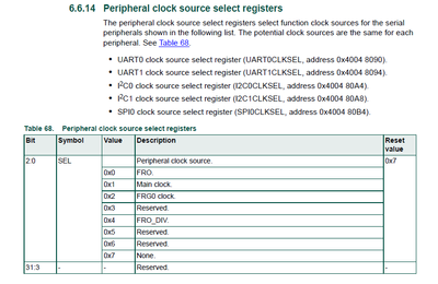

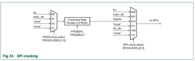

xiangjun_rong
I have tried your code, I suppose that the SPI clock is incorrect:
original line:
SYSCON->SPI0CLKSEL|=1<<11; //SPI CLK
change to
SYSCON->SPI0CLKSEL=1<<11; //SPI CLK
The SEL default value is 7, which means none of SPI clock. After you or with 1, it is still 7, you should have been set it as 0x01.
I used the following code, I can see clock signal SCK and MOSI from PIO0_15/PIO0_16 of LPCXPresso804 board.
Hope it can help you
XiangJun Rong
