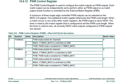

I use LPC804's P0.18 to be PWM output. and use the SDK in the test, it is found that when the program is executed( base->PWMC |= (1UL << (uint32_t)matchChannel);), it will output high level.
Very strange phenomenon, this high level is not acceptable.
tks a lot for your support.

Hope you´re well. Unfortunately, this is expected behavior as the User Manual suggests:
I apologize for the inconvenience this may cause you, if you have further questions do not hesitate to ask me.
