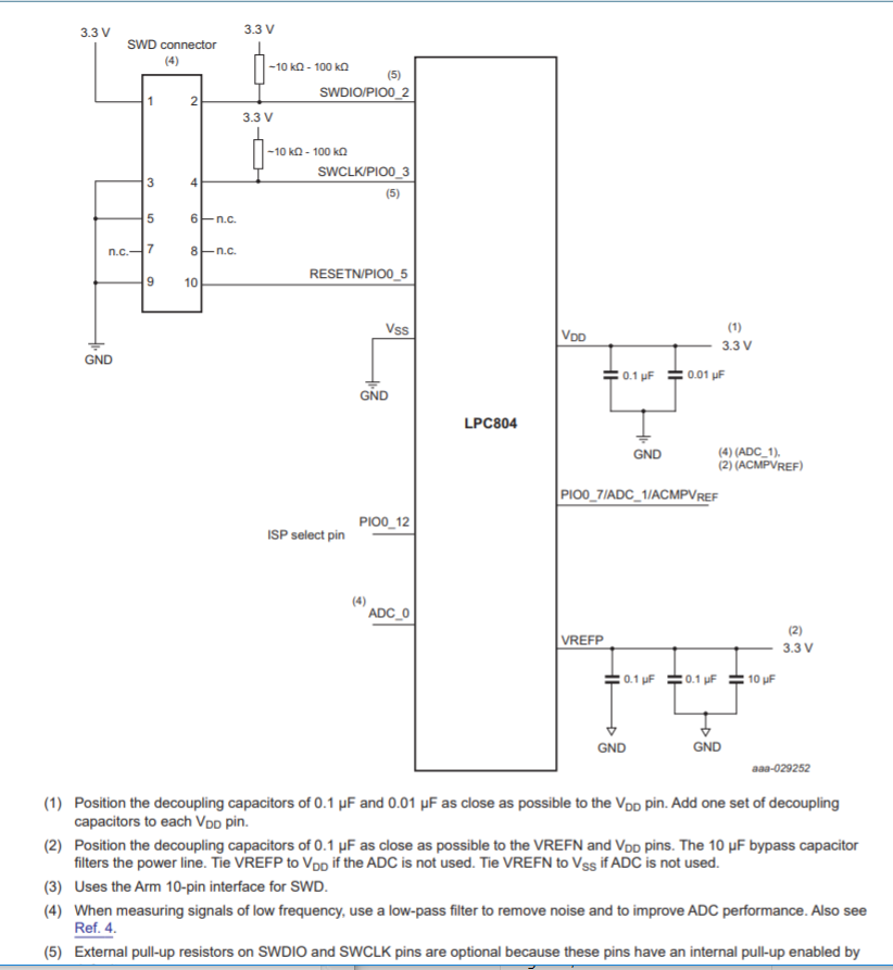

I can't connect to LPC804 used J-link, my schematic is as follows.
Please help to confirm if the schematic need to be modified.
Thank you

Please check the image below.
In addition please check the following thread: Design Considerations for Debug
