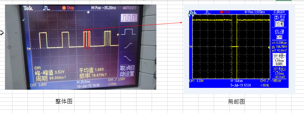

    I have some questions of RS485, in using NXP's MCU(LPC1518). Specific as follows:
     We configured the RTS signal to provide an output enable signal to control an RS-485 transceiver(USART_CFG[20] = 1).
      But, we found the phenomenon of abnormal that DE would be Low at Sending Data Operation incidentally.It continue about 6us.
      Could you have some suggestions about it ?
      Thank you very much.

shawn_ni
Hi Felipe;
      Thank you for your suggestion .
      However, the problem still exists(only Low become High).
      I uploaded the detailed waveform pictures for reference.
      Can you  help us analysis this problem again ?
Thank you very much,

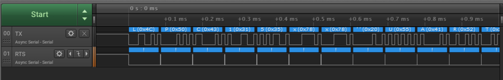

FelipeGarcia
Hello Shawn,
I did some testing on my side using LPCXpresso1549 and I found the following behavior in the RTS signal when transmission is taking place, please see snippet below:
Could you please confirm if this is the same issue you found on LPC1518?
Felipe

shawn_ni
Hi Felipe;
      Yes, that's the same issue.(only diffrent in OEPOL bit set)
      And we did the same testing on LPC1751.
     The phenomenon of DE(RTS) is always High When transmission is taking place .
     Waveform figure as below  for reference to you:
     We are looking forward to your advice~
Shawn
2,587 Views
FelipeGarcia
Hi Shawn,
I am going to ask about this issue internally. This seems to be a design error but I will let you know as soon as I have a response.
Felipe
