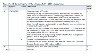

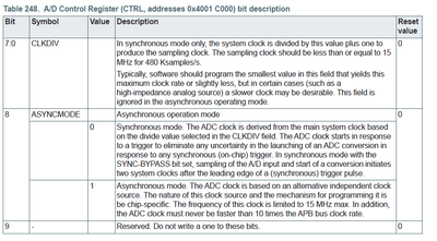

emmanuelJJ
Hi carlos,
The field CALMODE is no more mentioned in ADC control register (User manual UM11045)
So, how can we  do the auto calibration?
emmanuelJJ_0-1658241105437.pngemmanuelJJ_0-1658241105437.pngemmanuelJJ_1-1658241115775.pngemmanuelJJ_1-1658241115775.png
Emmanuel
