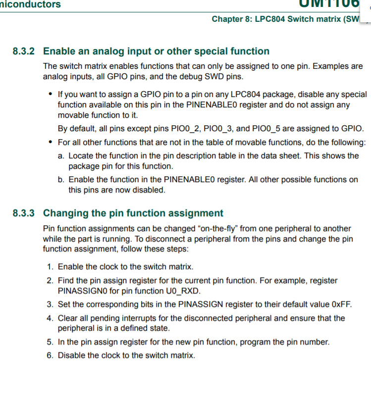

Is the LPC800’s switch matrix reconfigurable during run? Or is it just able to be configured at boot?

I found the following information in the user manual:
Pin function assignments can be changed “on-the-fly” from one peripheral to another while the part is running. To disconnect a peripheral from the pins and change the pin function assignment, follow these steps:
1. Enable the clock to the switch matrix.
2. Find the pin assign register for the current pin function. For example, register PINASSIGN0 for pin function U0_RXD. 3. Set the corresponding bits in the PINASSIGN register to their default value 0xFF.
4. Clear all pending interrupts for the disconnected peripheral and ensure that the peripheral is in a defined state.
5. In the pin assign register for the new pin function, program the pin number.
6. Disable the clock to the switch matrix.
