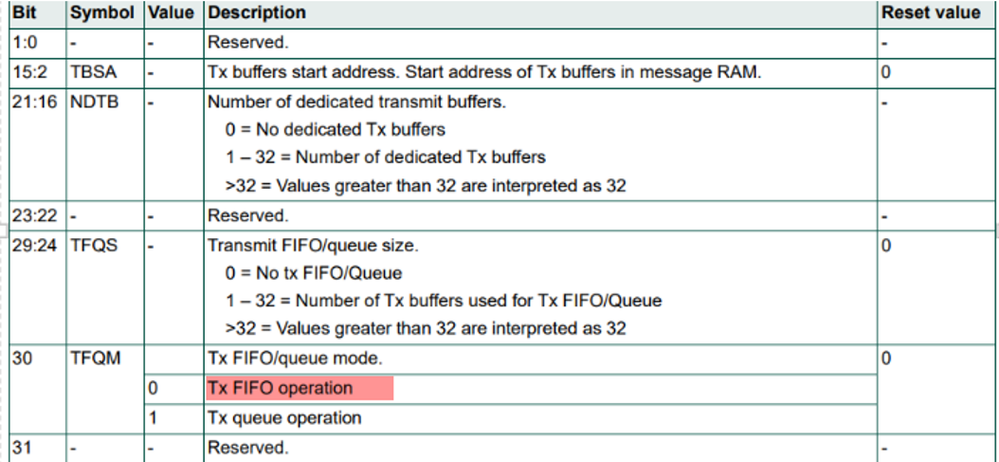

Please check the LPC550x, 1x, or 3x SDK MCAN examples.
Please make sure that txBuffer.mode equals 0 before initializing the MCAN Tx buffer (refer to the main function of the examples)
This will set the Tx FIFO operation mode in the TXBC register:
Additionally, you can modify the dedicated Tx Buffers; refer to txBuffer.dedicatedSize member of Tx Buffer config. structure.

Thanks for Your answer, the *.mode value is set automaticaly by the configuration tool (I have check and its set to kMCAN_txFifo = 0).
But my problem was that when You decide to configure, for example, 32 TX FIFO Buffers, the driver will only use 1 element of the FIFO, because the only possibility to write a new TX Message is when the state machine inside the driver is in kMCAN_StateIdle (for a given buffer Index), an this is set only when MCAN_TransferAbortSend is called. But this function is called only when the kMCAN_TxTransmitCompleteFlag is set in the IR register, so I can only wite a new TX Message once the prior message was transmitted.
Newer mind, I have decided to use 32 single TX Buffers and handle the filling of the buffers by my self. This works ok because 32 different buffer index's are used.
