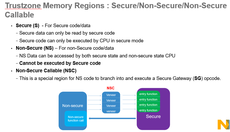

Hi Eugene
Secure region can access NS region.
BUT NS region can't access secure region directly. it must get through NSC . see below
For demo code, see ..\SDK_2.7.0_LPCXpresso55S69\boards\lpcxpresso55s69\trustzone_examples\hello_world.
It includes how to call S region function from NS region.
