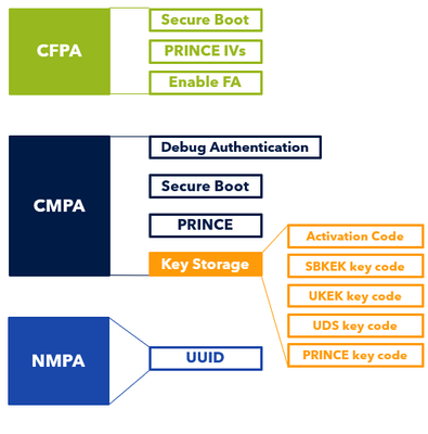

Let me see if i can put it another way. I can use PFR to develop appropriate protection. Should i do it "directly in software"? Can i do it from outside, from MCUXpresso, for example?

The Protected Flash Region PFR is the persistent storage for specific areas. This memory area is only accessible using ROM APIs or through blhost commands while in ISP mode.
PFR is composed of 3 regions
CFPA Customer Field Programmable Area
CMPA Customer Manufacturing Programmable Area
NMPA NXP Programmed Area
Inside the CMPA, a key storage area including the PUF activation code and several key codes.
Each region has a SHA256 hash digest field in the last 32 bytes. This digest is used during the deployment life-cycle state to cross-check integrity.
