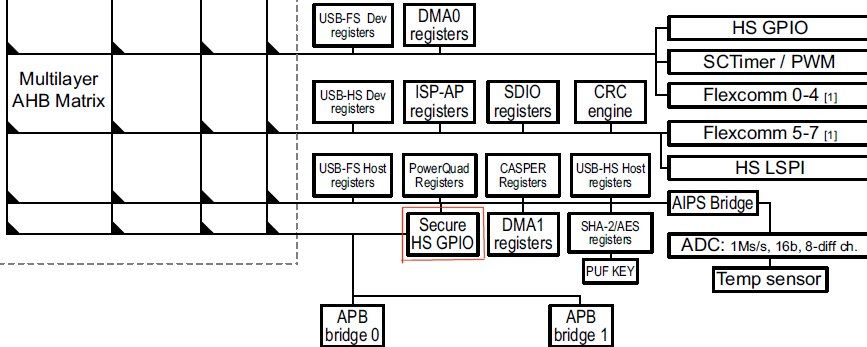

On block diagram in device datasheet Secure HS GPIO is connected to AHB Matrix with two lines.
What is this? Two masters can use Secure HS GPIO simultaneously? Drawing error? Something else?

Hello @jh0
This is  drawing error, there only need one line, thanks for your sharing.
