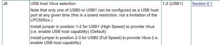

  2. Could you explain USB0_VBUS role in host mode? LPC55x documentation has no coverage on this. Is there an older MCU doc that talks about this?
  3. Does LPC55S6X-EVK support using USB0 as host? I see this being exposed as PIO22 on the headers, but not sure what else is needs to be done to get the host functional

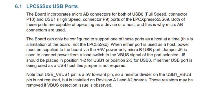

Hello @manuela_mendez
  • The USB0_VBUS should be connected to 5V.
  • When USB0 functions as a host, the USB0_VBUS is used to supply power to the USB device and also to detect whether the device is connected or disconnected.
  • The LPC55s6x-EVK supports USB0 as a host. Please refer to the LPCXpresso55s69 User Manual for configuring the hardware. Hardware please refer to schematic of lpcxpresso55s69-evk.
https://www.nxp.com/webapp/sps/download/preDownload.jsp?render=true
https://www.nxp.com/webapp/Download?colCode=LPC55S69-SCH
  • The USB host example uses USB0 by default. Please refer to the relevant documentation for further details.

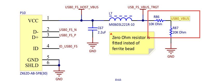

Regd. you comment "The USB0_VBUS should be connected to 5V" --
on p44, Rev. 2.3 of LPC55S2X_LPC552X datasheet it states the following:
[6]
The corresponding VBUS must be connected to supply voltage when using the USB peripheral. USB0_VBUS is not 5 V tolerant pin and is tolerant up to
3.6 V only when the VDD is at operating level (minimum: 1.8 V). USB1_VBUS is 5 V tolerant pin regardless if the VDD supply is present or not.
it doesn't talk about the host mode, but still it is confusing - that was the reason for me to think it needs to be connected to 3v3.
1,863 Views
Yes, you are right. So design USB0_VBUS as below:
Alice

manuela_mendez
Hello @Alice_Yang: thank you for the confirmation!
