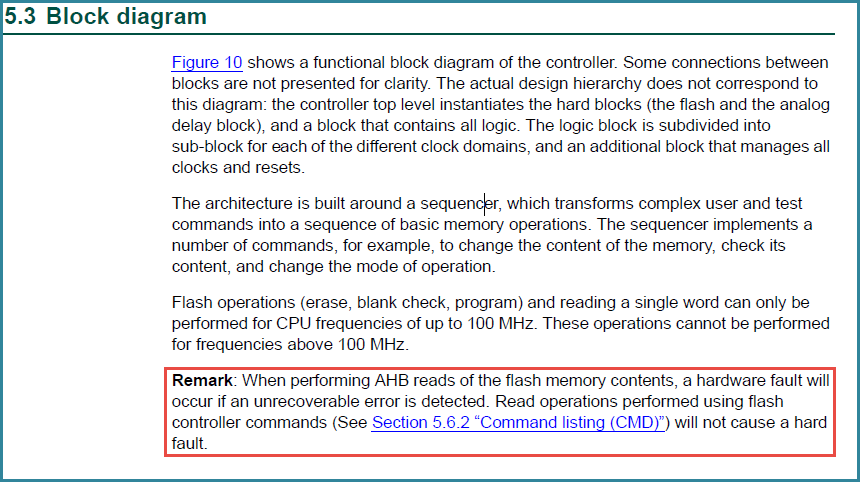

ZhangJennie
Hi Eugene,
As the suggestion from UM11126,
"Read operations performed using flash controller commands (See Section 5.6.2 “Command listing (CMD)”) will not cause a hardfault."
I am preparing an article on this issue. I will update you once I post it to community.
Jun Zhang

4,295 Views
ZhangJennie
Hi,Eugene Hiihtaja
LPC55Sxx checks FLASH ECC while AHB read. During IDE debugger connecting a LPC55Sxx board, FLASH is mass erased first. The LPC55S69 mechanism is, FLASH contents are erased but the ECC values are not updated with that erasing. Therefore, when executing FLASH read code ( for example, mytemp = *(uint32_t*)0x4000 ) through AHB bus, it detects the ECC values not match the erased memory content, which leads to fail to read and go to HardFault_Handler.
Unlike mass erasing, programing FLASH updates the related ECC value. Thus with a successful ECC check, read AHB can be realizable by below code.
volatile uint32_t mytemp;
mytemp = *(uint32_t*)0x1000;//read memory content 0x1000 to mytemp
NOTE: 0x1000 MUST be a “programed” address.
The unused FLASH sector is in “erased” state, thus in order to read it, we need manually program it before AHB read.
Jun Zhang

4,295 Views
ZhangJennie
I would suggest you refer my article method two. This is also UM suggested method of read Flash.
How to fix LPC55Sxx AHB Read HardFault Error
https://community.nxp.com/docs/DOC-345423
