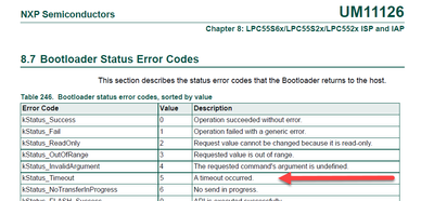

I believe you are referring to the timeout value. You can set this timeout value using the blhost.
When a timeout error occurs you should get the following error:
This will be part of the sequence done when communicating through ISP.
