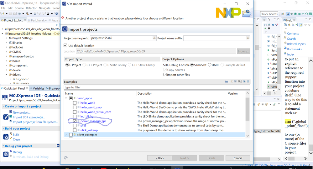

If you want to measure the current of the LPC55S69 on board, I suggest you run the example code "power_manage_lpc" example, because the LPC55S69 remains low power mode for a long time so that you have enough time  to measure. In the example, it wakes up by either by pressing a hardware button or a long time RTC waking up interrupt.
The freertos_tickless example enters/exits low power mode frequently, it is difficult to get the correct aperture to measure the current in low power mode by a current meter.
